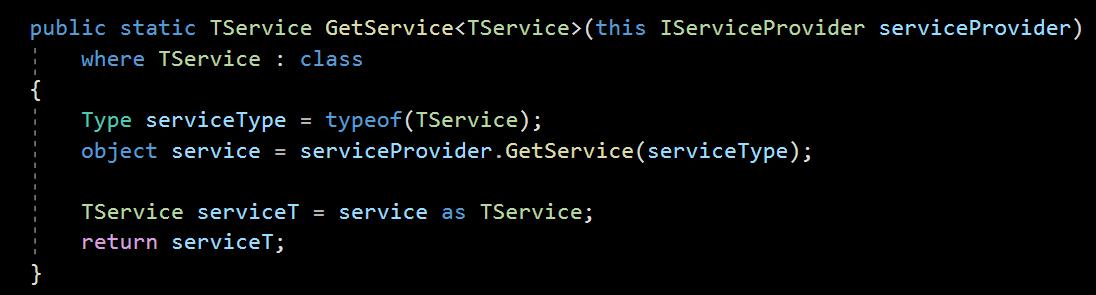

I recently needed to remove a duplicate extension method from the Paint.NET code base. I had two copies of a ServiceProviderExtensions class, one in the PaintDotNet namespace and the other in PaintDotNet.AppModel (which I wanted to remove). They both had a GetService<TService>() extension method:
